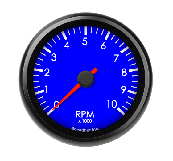

Those little tach/hour meters are cheap but I've heard about response time issues for years. They seem somewhat crappy. At one time I was considering this.
The size seems good for our bikes. I like all the options and a stepper motor ought to give better response (no guarantee). But not waterproof is a downside and will require some sealing.

I was playing with the options for a different Speedhut 2 5/8" tach and came up with this today:
Not bad!
