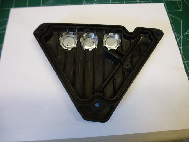

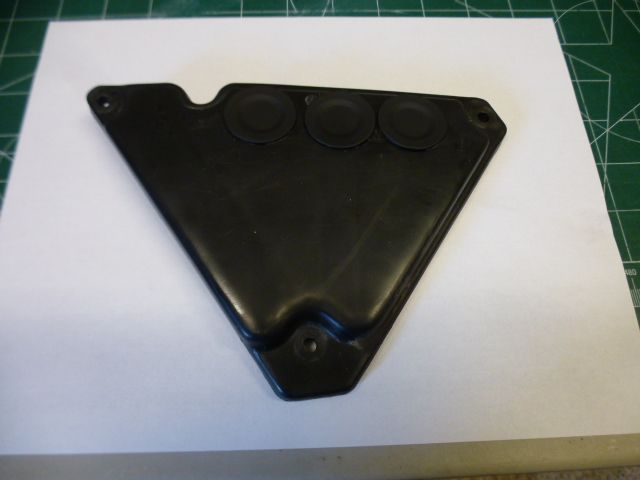

I ended up using 3 - 3/4" conduit plugs (required 1 1/8" holes)
all 3 fit across the top of the airbox hidden by the side cover

Here's how my mod came out, hope pics are not to dark

Very professional. Please keep us posted on how it performs with 1, 2, and 3 holes open (assuming there is any noticeable difference).

Thanks! my holes were a bit off the target but good enough!
I was thinking poping a plug every 3000' in altitude for starters and just adjust from there

Nice work. You could actually "jet" to run a bit rich at Sea Level, and open up one plug to compensate.

air box mod installed and ready for testing
can't tell it's there....
